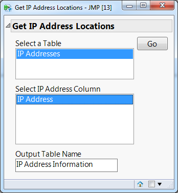

Below is a screenshot of the add-in after being launched from the add-ins menu. Select the appropriate table and the column that contains your IPv4 adresses. Click the Go button to create a new table with geolocation information.
Get IP Address Locations Add-inGet IP Address Locations Add-in

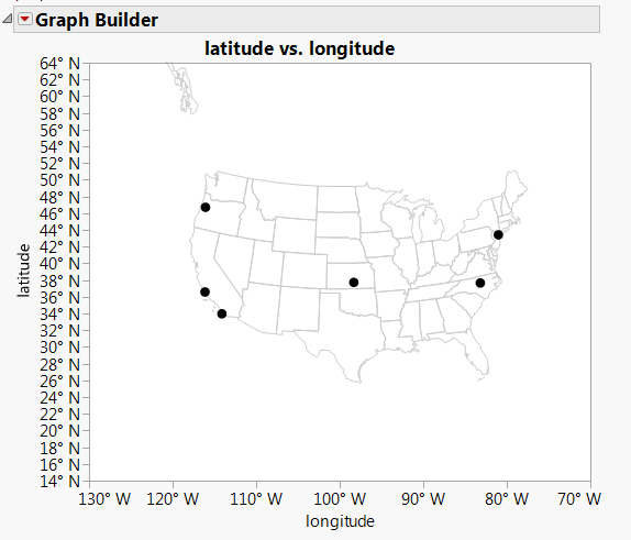

Geolocation Output TableGeolocation Output TableYou can either use the Tables > Join or the new Virtual Join feature in JMP 13 to join your data together to plot. Below is a quick graph that I put together based on the data table above using Graph Builder and US State outlines.
Graph Builder MapGraph Builder Map
