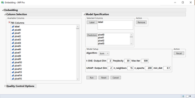

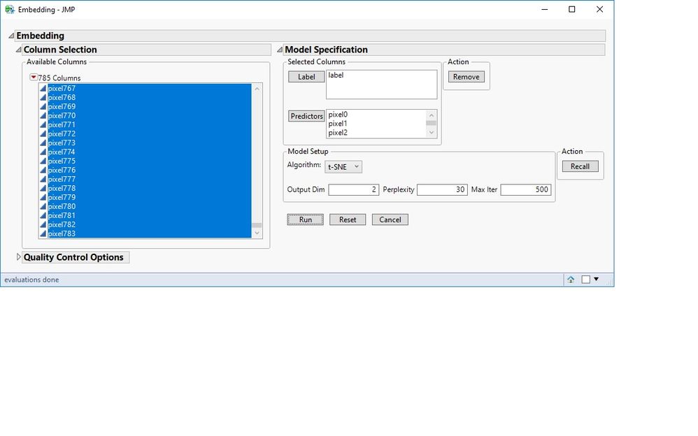

Here is a screenshot of the interface with MNIST data loaded. Under Model Specifications, I selected the label column as Label and all the pixels as predictors. I chose both t-SNE and UMAP as the algorithms.
Another screenshot of the results of both t-SNE (top) and UMAP (bottom).

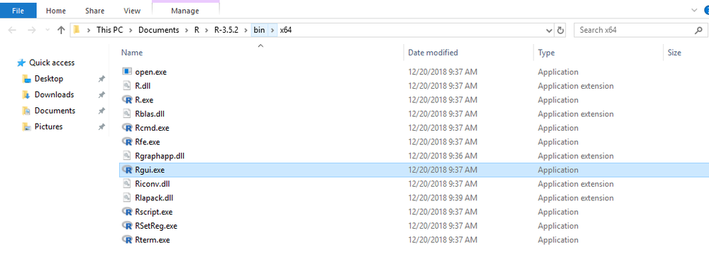

marxx
Hi MJ,

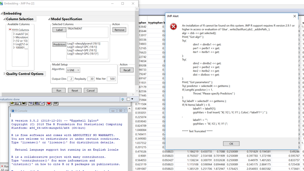

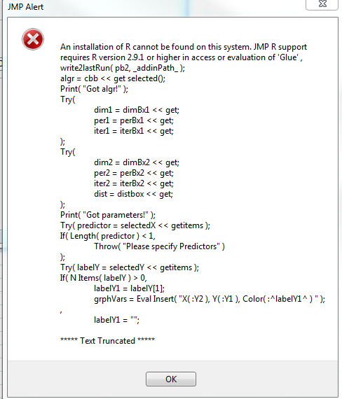

I am getting an error message when I try this addin. It looks like it is not recognizing my installation of R. Would you be able to help figure out how to get your addin to recognize my R installation if that is indeed the issue?
I am including a screenshot showing that R is open but not being recognized, and a screenshot of my R install location (not program files) and also copying some of the error message below.
This looks like a very exciting tool and I am hoping to use it. I've previously found t-sne in R to be useful and it would be of great value to be able to do this right in JMP. Any help you might provide is greatly appreciated.
Thanks!
Screenshots of error and open R instance, then screenshot of R install location
Error code
An installation of R cannot be found on this system. JMP R support requires R version 2.9.1 or higher in access or evaluation of 'Glue' , write2lastRun( pb2, _addinPath_ );

MJ
Hi marxx,
Your problem was likely caused by multiple installations of R on your machine and JMP couldn't decide which one to use. Please try to set R_HOME as an environmental variable as following and try this add-in again. Open Window CMD console and type: setx R_HOME "This PC\Documents\R\R-3.5.2". And make sure Rtsne and umap packages are installed to this version of R. Please let me know if this solves your problem.
Also, we have a few threads on the community talking about this issue that you can check out.
https://community.jmp.com/t5/Administration-Discussions/Help-JMP-find-R-installation/td-p/6357
https://community.jmp.com/t5/Discussions/Setting-path-to-R-location/td-p/59764

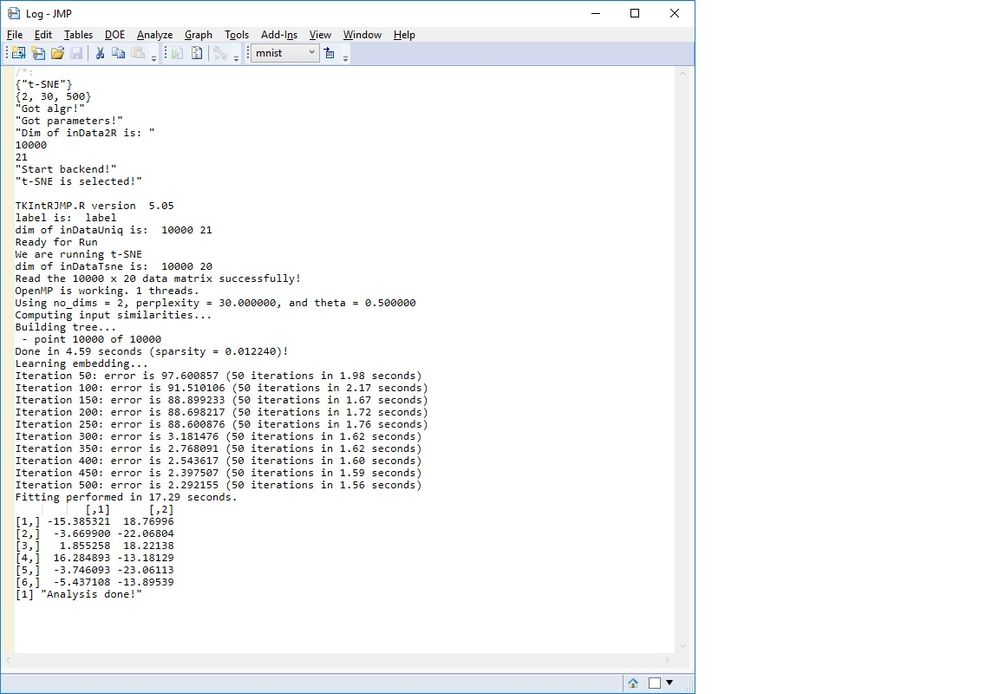

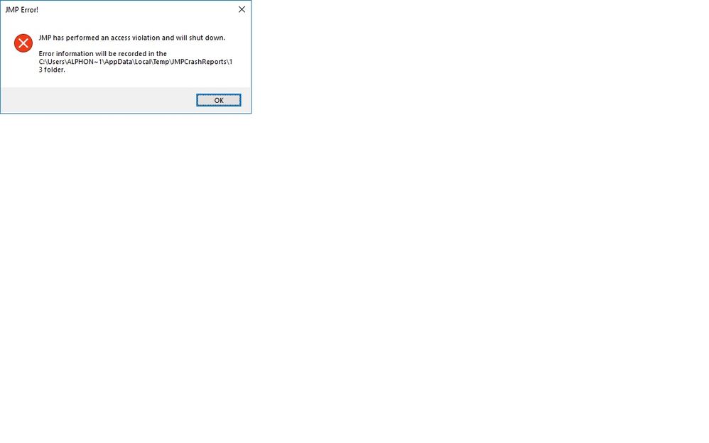

ngalphie
Hello @MJ,
I tried running your sample data, but had a access violation crash. In the log file, it looks like the R-side ran successfully. Any ideas how I can address the issue?
Thanks,
Al
MJ
Hi @ngalphie, this looks like a problem with the older version of JMP.
1. I noticed that you are using JMP 13, it might be helpful if you can update it to the latest version (JMP 14.3) and try this add-in again.
2. Send the crash report saved at C:\Users\username\AppData\Local\Temp\JmpCrashReports\13 to me to tech support (https://support.sas.com/ctx/supportform/createForm?ctry=us_JMP) or me directly (Meijian.Guan@jmp.com), we can dig into it.
3. There are a few posts on the community also talking about this issue. You can take a look to see if there are anything they mentioning could help.
https://community.jmp.com/t5/Discussions/JMP-has-performed-an-access-violation-and-will-shut-down-wh...
https://community.jmp.com/t5/Discussions/JMP-Access-Violation-Likely-Causes/m-p/5648#M5647

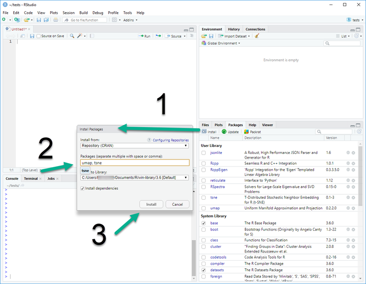

FN
I managed to run umap but not via Anaconda/conda.
I think I am installing the wrong package for tsne. Can you provide the URL in cran?
Here is the step by step.
Intall R from https://cran.r-project.org/
Install Rstudio commnutiy https://www.rstudio.com/products/rstudio/download/#download
Use Rstudio to install tsne and umap.

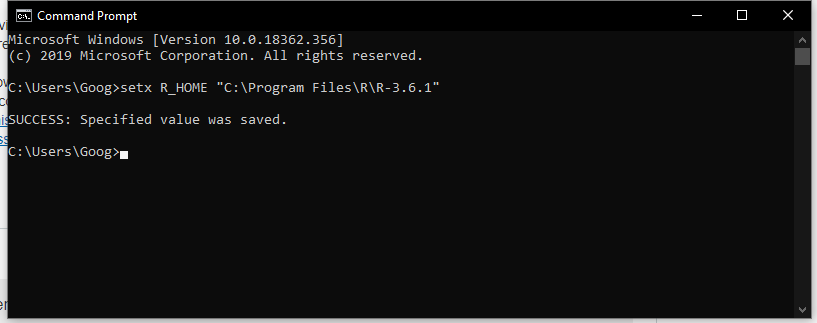

Dear @Raaed, I believe I have responded above regarding this issue. It's likely because JMP R Interface had trouble finding your R installation.
Please try to set R_HOME as an environmental variable as following and try this add-in again. Open Window CMD console and type: setx R_HOME "Path to R". And make sure Rtsne and umap packages are installed to this version of R. Please let me know if this solves your problem.
If you are using Mac, you need to downgrade your R to version 3.3.3 and only use T-SNE.
Hope that helps!

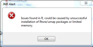

When attempting to run the program on the test data set, I got an error saying "Issues found in R, could be caused by unsuccessful installation of Rtsne/umap packages or limited memory."
I'm pretty sure I downloaded everything I need (the packages and R, too), so if you could clue me into why this isn't working, that would be much appreciated
Regards,
Dhruv Bhattaram
MJ
Hi @DBhattaram, it's possible that JMP didn't find the right R version, or the R versioning issues with JMP R Interface. Could you please open the log file (CTRL+Shift+L) when you see the error message and send the detailed log info to me at Meijian.Guan@jmp.com? I'd be happy to take a look.

Hello, I have the same error saying "Issues found in R, could be caused by unsuccessful installation of Rtsne/umap packages or limited memory." I installed UMAP and TSNE from Rstudio. I use R x64 3.5.2 under Windows
MJ
Hello @Lu, sorry for lacking details in the error message. Could you double-check if you installed Rtsne instead of TSNE package in R? Let me know if that fix your problem.

Just installed the add in and now JMP can't find my R ... I've reset my environmetal variables, changed the path in CMD, reinstalled R and nothing.
I get the error saying R is not installed. This doesn't seem as an effective add-in with all these problems that are avoided if T-SNE is just run in R. The GUI is nice, but this seems to be a headache based on all the comments.
ih
@MikeDereviankin,
In case it helps, this text is from the "How JMP Finds R" section of the JMP 15 scripting guide . From my experience setting the environment variable from within JMP is the safest method.
JMP delays loading R until a JSL-based script requires access to it. When JMP needs to load R,
it follows the standard steps for finding R on a Windows computer:
1. Look up the environment variable R_HOME.
If the variable exists, load R from the specified directory.
2. If the environment variable R_HOME does not exist, look up the InstallPath value in the
Windows registry under the following key:
HKEY_LOCAL_MACHINE\SOFTWARE\R-core\R
If the InstallPath value exists, load R from the specified directory.
3. If the InstallPath value does not exist, an error message states that R could not be found.

@MikeDereviankin My apologies for the R integration issues, usually having single R installation, restart R, JMP, or even your machine would help in this scenario. After you going through these troubles, you might appreciate the convenience and the interactivity of this add-in.
