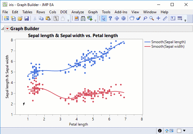

Re: zoom out in graph builder
Confirming what @danschikore observed, at least on Windows, using Alt + the magnifier tool seems to reset both axes.  An example:
