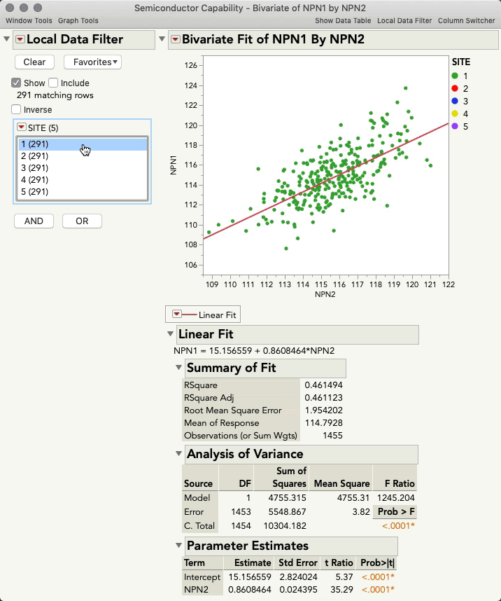

Finally, if keeping all the rows together for analysis is necessary, but you have a need to see the points separately for each group, a Local Data Filter, with only "Show" checked might do the trick.
Open( "$SAMPLE_DATA\Semiconductor Capability.jmp" );
Bivariate(
Y( :NPN1 ),
X( :NPN2 ),
Automatic Recalc( 1 ),
Fit Line( {Line Color( {212, 73, 88} )} ),
Local Data Filter(
Mode( Include( 0 ) ),
Add Filter(
columns( :SITE ),
Where( :SITE == 5 ),
Display( :SITE, Size( 181, 85 ), List Display )
This allows you to toggle through the levels of the grouping variable to see all the points unoccluded, but since "Include" is not checked, the local data filter does not affect which rows are available for the analysis.
