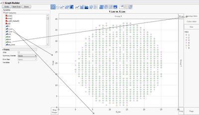

I normally use Graph Builder to do this.
It really depends on what type of data you looking for. For example, i often use this to check my Wafer testing (Chip Probe , SORT) hard bin results.
1. Put X-Loc to X-axis
2. Put Y-Loc to Y-axis
3. Put the Hardbin to Overlay
And you can see the whole wafer by its hardbin.

feihoong
Level I
Re: wafer map
