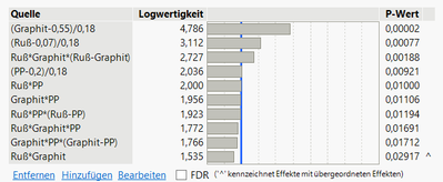

i am using a cubical scheffe polynomial to model my system and i am having difficulties interpreting the analysis for one response. I am posting my analysis results for you to look at. Thanks in advance for your help.
This are estimates for the parametes and the effect tests

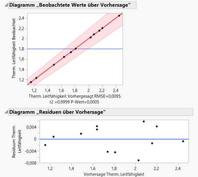

I have a very high r^2 which made me even more suspicious. r^2= 0.999 and of course very small residuals
Finally all the terms appear to be significant. Think is why i believe there might be some overfitting at work, but i am not sure.

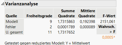

A Scheffe cubic model is used to fit a model to a mixture. In other words, all observations must add up exactly to 1. No rounding errors are allowed. A quick way to check this is to look at the Analysis of Variance table (which is not included here). It should have a message at the bottom stating "Tested against reduced model: Y=mean". If your message says 0 instead of mean, then you are not fitting a mixture model. It is a no-intercept model which would explain some unusual results. That should be fixed before doing anything else.
Once you are sure that you are indeed fitting a mixture model, why are you suspicious of these results? If the results are truly too good to be true, how many degrees of freedom are in your model error? You can see this from the Analysis of Variance table also. A low number of degrees of freedom (which I suspect that you have), could also lead to the model being overfit. You may have close to a saturated model, meaning there are not enough degrees of freedom in the error term to capture the variability of the system. Do you have any replicates in your data? Adding replicates to any set of data will allow you to better estimate the error of the system.

From the output I can tell that the analysis is a true Scheffe model, which is good. Although you have 11 degrees of freedom (12 runs), you only have 2 degrees of freedom for error. In other words, your model has 10 terms. There are not many extra runs to estimate the error of the system. However, before adding additional runs (which, using Augment would be a good approach), do you believe the error is really too low? Check your Root Mean Square Error from the Summary of Fit.  That number should be close to the standard deviation of your system when running at steady state. Does it look correct? If it does, then I will ask the question again: why do you think this fit is suspicious? Remember that the tests on the main effects of a Scheffe model are not relevant and should be ignored. You would only look at the tests on the "interactions". Maybe they all really should be significant?

thank you very much for your response. The response i am measuring is thermal conductivity and the std. deviation of the process is indeed very low.  But it is not as low as the RMSE of the analysis. This is why i decided to replicate some points (5) so as to try and get a better fit.
