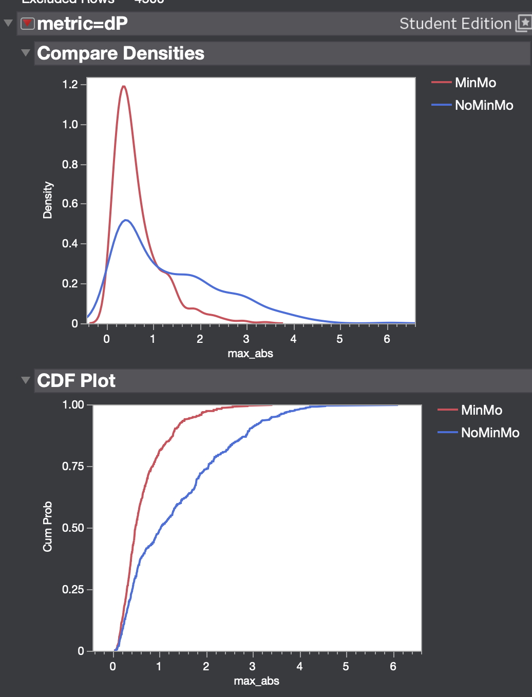

In the simple Oneway analysis platform, there is an option to compare what I understood to be probability densities from x conditions, along with the CDF.   However, the y-axis scale is ... confusing, in that it goes above 1 (as shown in fig).   And in fact can go up past 2.5.
Anyone know what this number actually represents? I couldn't find it anywhere in the documentation.

Compare Densities
Shows or hides a plot of overlaid probability density functions for each group.
https://www.jmp.com/en/statistics-knowledge-portal/inferential-statistics/probability-distributions , The range of the PDF is non-negative and the integral over all values of the random variable is one.

thanks - yours truly was confusing probability density and probability mass....
