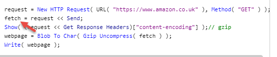

Interesting. Amazon is compressing the data. Two ways to fix it; the new http request way lets you check if it is compressed:
webpage = Load Text File( "https://www.amazon.co.uk", blob() );
webpage = Blob To Char( Gzip Uncompress( webpage ) );
Write( webpage );
// the better way...
request = New HTTP Request( URL( "https://www.amazon.co.uk" ), Method( "GET" ) );
fetch = request << Send;
Show( (request << Get Response Headers)["content-encoding"] );// gzip
webpage = Blob To Char( Gzip Uncompress( fetch ) );
Write( webpage );

  • Can JSL detect if fetch is in compressed format?
Thanks Experts!
Craige_Hales
Re: utf-8 encoding - cant read html
Line 1 creates a HTTP Request object and puts it in the request variable. The amazon url is in the object's data, but no communication has happened yet so the request object doesn't know what will happen.
Line 2 sends the GET request to amazon; the payload part of the answer from amazon is copied into the fetch variable. You'll see a note in the log that a blob was stored because the data was binary data rather than proper Unicode. There is other metadata from amazon as well; the headers amazon returns are kept in the HTTP Request object.
Line 3 prints a value from the stored headers--specifically the content-encoding header. This needs to have more if(...) logic to test if there is a content-encoding header in the associative array, and then if its value is "gzip" before choosing to decompress the payload.
Line 4 depends on fetch holding a gzipped blob for the payload. It then depends on the binary data that was unGzipped being valid UTF-8 that can be converted to characters.
Line 5 prints all the payload data; there is a lot and JMP will truncate it in the log if you don't explicitly write(...) it.
