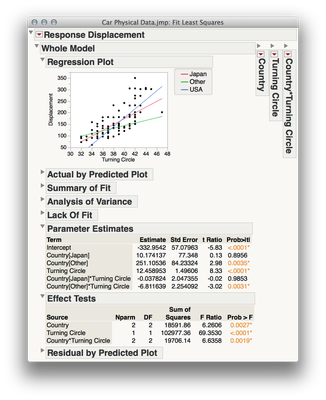

This yields the output above. Of most interest will probably the be the Parameter Estimates, and Effect Tests sections. If we look in the Effect Tests section under the interaction (Country*Turning Circle) we can see we have rejected the null hypothesis that the slopes are the same in each country -- e.g. we have evidence the regression of displacement on turning circle differs between the countries. Under the effect of Country we see we have not rejected the null hypothesis -- we do not have evidence that the MEAN displacement by country differs. If we really want a test of whether the intercepts of the models differ by country we need to uncheck "Center Polynomials" in the Fit Model specification under the Red Triangle. If we do that, we get the following output:
