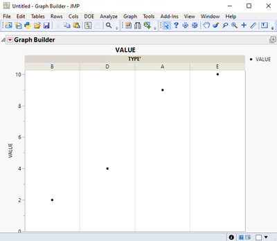

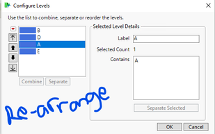

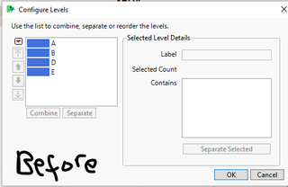

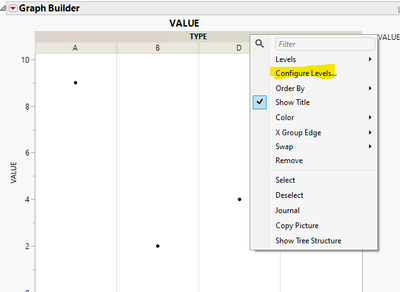

If it is from the graph builder itself (JMP 18.2);
1. Move cursor at the Type & right click. Select "Configure Levels"
2. Click the Type that you want to order. Let say A. Then, click the arrow Up or Down / Top or Bottom
3. Result
3. Result
