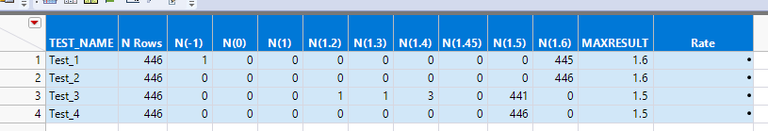

I have a summary table where I'd like to create a new column 'Rate' with a formula. The column MAXRESULT gives the name of the column I want to use in the formula. unfortunately, I'm getting 'missing arguments' error when I create the formula based on column name.
Column 'Rate' formula:
(100 * Column Name( Parse( "N(" || Char( :MAXRESULT ) || ")" ) )[]) / :N Rows
What's wrong ?

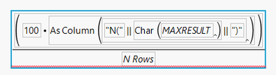

One option is to use As Column() or Column() instead of Column Name() (with As Column() you shouldn't need []). Also there should be no need to use Parse().
Something like this
(100 * As Column("N(" || Char(:MAXRESULT) || ")")) / :N Rows
-Jarmo

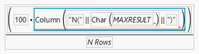

Re: use a value to find the correct column to use in a formula
Hi,
the proposed formula still doesn't work :(
Error unresolved column
Error Could not find column
anything else I can try out ?
Thanks for your support
ok it's working on my data set as well.
the strange thing is it's still showing the error in the preview but then when I apply the formula, the result is good.
Thank you all !
jthi
Formula editor doesn't like the formula. There are quite a few formulas which can have those red-underlines but they will still work (using Current Data Table() for example). In this case I think it is caused by not evaluation the column names into the formula
