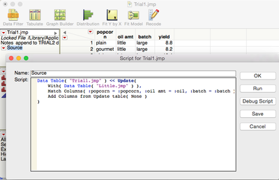

Looking at the Source script that's added to my table after I do an Update with that option I see that the script is:
Data Table( "Trial1.jmp" ) << Update(
  With( Data Table( "Little.jmp" ) ),
  Match Columns( :popcorn = :popcorn, :oil amt = :oil, :batch = :batch ),
  Add Columns from Update table( None )
-Jeff
-Jeff
