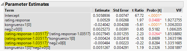

Thanks for posting that.  It clears up a lot of confusion.  Centering is not going to do anything for you in this case since you are not asking to model any higher order effect that involve rating.response.capture1.PNG
If you did include interaction with rating.response, you'd see the interactions with that effect are centered by the mean rating:

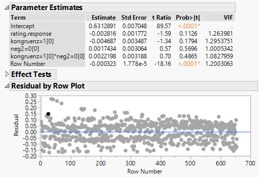

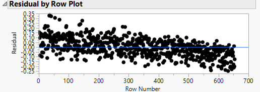

I'm sure you noticed a high degree of non-normality for that response.  Based on the Box-Cox plot, I would recommend a power transform using the value -0.5 (reciprocal of square root).  There's also a problem with independence: a very obvious trend in the residuals following the row order (does row order correspond to time order here?).  Not sure what is going on there, but that is a big question that ought to be addressed.  This residual plot shows the problem with the transform, but you can see it before the transform as well.capture3.PNG
If you add a row-order column as an additional effect, you can account for that (still leaves some major questions).  However, the row order is literally the only effect that is statistically signficant.  capture4.PNG
