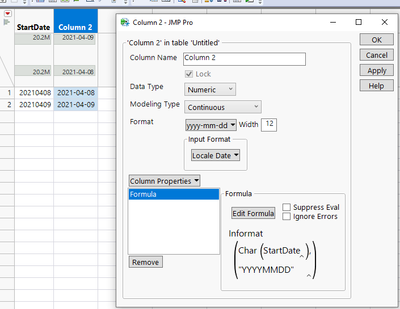

Create new formula with the formula I provided earlier, you should end up with something like this:
Then change the Format to what fits you best
You can do this in place, but I would suggest:
  1. Creating new formula column
  2. Changing Format
  3. Verifying everything works as you want to
  4. Deleting old column if you don't need it
  5. Renaming new column
If you have to do this often, then I would look into using JSL and scripting it (I think Activity Recorder/Enhanced Log in JMP16 can record all of these steps to make scripting very simple).

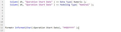

I know but when I do,  nothing happens

Try
column(dt, "Operation Start Date" ) << Input Format( "yyyymmdd");
Jim

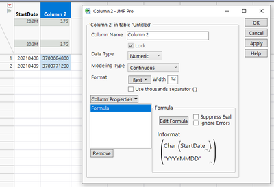

Re: transform column
The reason is that JMP uses seconds since 12:00 AM January 1, 1904, as its base for time values. Your numbers are integers that code the year, month, and day. JMP has many built-in functions for working with date and time values. That is why @jthi's solution is so simple.
