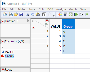

Here is a simple data table

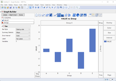

and if you drag the Value column to the Y axis, and the Group column to the X axis, and select the bar chart icon, here is what you get

Thanks very much, I was loading it into graph builder, this works perfectly.
