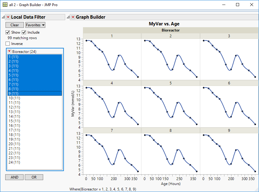

David_Burnham
Re: time course data in microtiter plate format
I'm not sure you need to use the map.  I would just plot my variables versus time, wrapped or filtered by vessel
-Dave
-Dave
