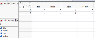

also, I want to later do some calculation and append value to the associative array. Then turn the associative array into table. Below is the example how I do it. the aa's value is correct with {{}, {}, {"3", "2"}, {"A", "b"}}, but the table created only has value in :rain. I think it is because jmp default column data type is numeric+continous.
1) is there a better/faster way or forcing way to turn associative array into a table without the need of defining column data type?

missing :today value because it is character
