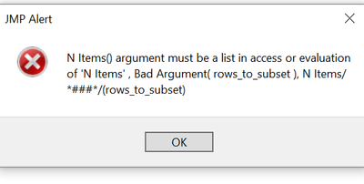

The other two still returned errors:
So I will use the second suggestion.
