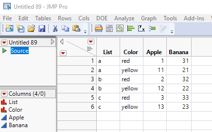

Now use Tables->Split to split the Data column by Fruit.
Now you'll get the data table you want with, an Apple column and Banana column.

If you Stack the data, then create a new column for the Fruit, and another one for the Color, you can then Split the data into the required data table.
The script below illustrates how to accomplish this.  However, doing the steps interactively is how I build the script, so you can easily repeat the interactive steps.
