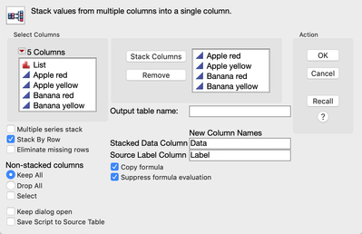

First, use Tables->Stack to stack your four columns (Apple red, Apple yellow, Banana red, Banana yellow) into a single column.
You'll end up with this:

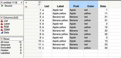

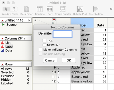

Now, use Cols->Utlities->Text to Columns to separate the fruit from the color in your Label column. Put a space in the delimiter field.
You'll end up with two new columns. Rename them Fruit and Color. You can delete the Label column.

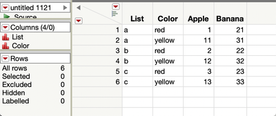

Now use Tables->Split to split the Data column by Fruit.
Now you'll get the data table you want with, an Apple column and Banana column.
