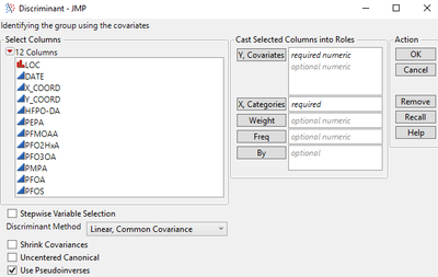

I watched your videos - very helpful!  Assuming I use Discriminant Analysis in JMP my Y covariates are obviously all my numerous PFAS compound fields. But it is unclear how my X, category/class field - "source" - is supposed to work.  I say this because I do not know what the source is for the vast majority of my dataset (which is why I'm doing this analysis).
Recall that my dataset looks like this:
I can add a source field to my dataset and populate it for about 10% of my rows (~1300 rows) because of the unique attributes of my study area.  However, I can populate it only for the "air deposition" source.  The other two sources ("process waste" and "mixed") are not easy to discern... thus my need to analyze my dataset (PLS for example).  If pressed, I could probably populate the "process waste" source also, but only for about 30 rows, not more.  The source field for the other 11,000 rows are unknown.
Am I misreading the workflow here?
P_Bartell
Level VIII
Re: should i use principal component analysis or k-means cluster analysis?
No you aren't misreading the workflow...if you can't populate the data table in the Loc column with the three possible levels of that variable then you can't build a model, PLS or any other method for that matter. So I'm going to suggest you go back to your original thoughts about multivariate exploratory data analysis tools like clustering or principal components analysis on the compound variables...at best if some clusters arise or a relatively few number of principal components emerge you'll be able to see them among the compound variables.
