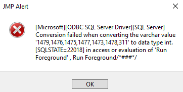

I want to set the start and end datetime as variable then insert into customsql. in method one below, JMP Alert of converting issue. When I simply hard coded the start and end date as variable, it run without issue. I check both the start and end date type in both method, both are string(). Event the custom sql after substitute into are identical. I cannot find out why the method one not working on date variable. Can someone help?? I really dont want to have to manually change the date everyday. How can I make method 1 works?

Does your method1 provide you with correct strings? It could be that the date is formatted incorrectly.

the method1 give the same identical string as method2 when I do show().
I tried your method, and still getting same error.

Checking your script again, you have tstart and tend different on method1 and method2. Maybe it is causing issues during the query?

dont think so, I tried same as method 2 but still have same issue.
could it be bug in jmp pro 16.2?
