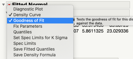

Once the analysis has been performed got the red triangle next to the Fitted Normal outline and select Goodness of Fit.
Selecting Goodness of FitSelecting Goodness of Fit

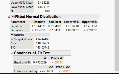

This will give you the desired output.
JMP Shapiro-Wilk W TestJMP Shapiro-Wilk W Test

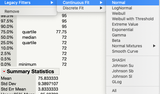

AV
AV
Level II
Re: shapiro-wilk test JMP 15
Hi,

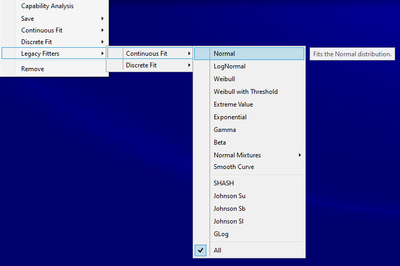

Even after enabling the legacy filters and going to
Legacy filters ====> Continuous fit
The Shapiro-Wilk option does not show up and if if you run Normal, the KSL test result is displayed. No other Goodness of Fit option under legacy filters. See attached image. (JMP 15.1.0 Pro)

Thank you very much for your quick reply and screenshots. I had done those steps and it still wouldn't work. I even reset the platform preferences to defaults just in case there was some bug. I was going crazy until I realized my sample was >2000, in which it would default either to the Anderson-Darling test only (through the new fitter, even when legacy fitter had been enabled) or the KSL test (if done via the legacy fitter). If I decrease my sample to below 2000, it works. Thanks again.

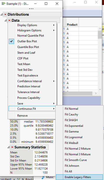

  3. Go to the red triangle next to the name of your column and select                                                   Continuous Fit==>Enable Legacy Fitters                                                           shapiro1.PNG

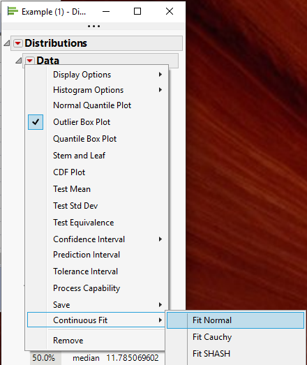

  4. Go back to the red triangle and select                                                                                                            Continuous Fit==>Fit Normal                   shapiro2.PNG

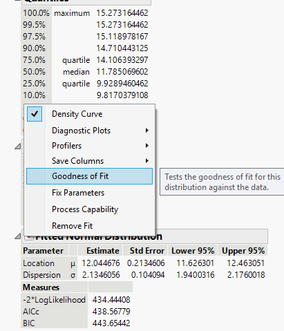

  5. Go to the red triangle for the Fitted Normal Distribution and select                                                               Goodness of Fit                                                                                                     shapiro3.PNG
