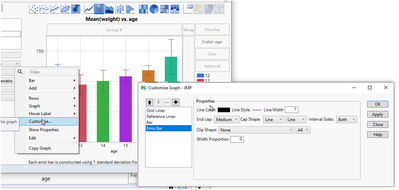

hogi
Level XIII
Re: setting Graph Builder error bar properties JMP Pro 15.2.1
"black magic" - or right click/customize:
