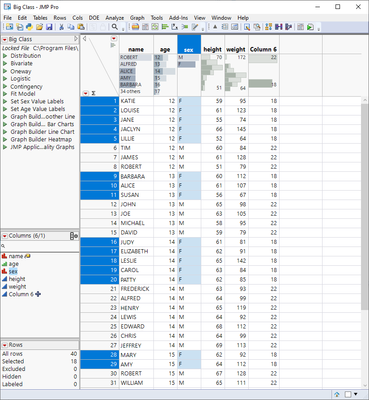

jthi
Re: JMP equivalent of Excel's COUNTIF function
Maybe Col Sum of 1 by failuretype?
Col Sum(1, :FailureType)
Here Column 6 has formula Col Sum(1, :age)
-Jarmo

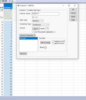

jthi
Create column with just Row() and you will see what it returns
You can do the same thing for
:failureType[Row()]
and for
:failureType
and finally for
:failureType == :failureType[Row()]
to see what you will end up with (you are comparing current row value of failure type to current row value of failure type with just different syntax, which is almost always 1).
-Jarmo
