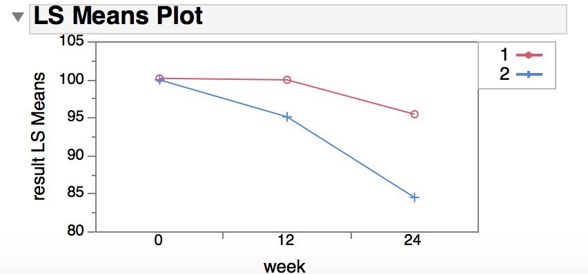

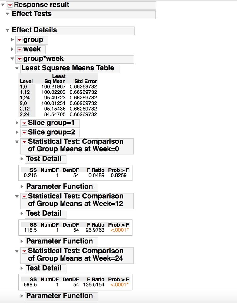

I thought about this for a while, and here is one approach, based on the specific analysis you describe. The data is best analyzed in "Fit Model", using least squares regression to estimate the effects of group, time period, and their interaction. You can also, in this analysis platform, get the plot you are interested in and do the statistical tests to to see if the group means are the same or different at each individual time point. If you were doing this manually, in the Fit Least Square report, make sure under Effect Details you find the results for the interaction term (group*week), and turn on the LS mean table, the LS Means Plot (use "group" as the grouping variable) and Test Slices. Test Slices will do all comparisons groups within a "slice" (one level of one factor held constant) -- the slice analysis for week=0 is testing if the group means are different at week=0, ...
This analysis uses "out of the box" functionality in JMP, and with some minor adjustment of the output (manually or with scripting), you can get the results and analysis you need. If you are newer user, this is often the better approach to use.
A more customized output often requires a bit more learning about JSL, particularly about how the report displays are built, and that takes a while to learn. Overlaying text on a graph is a bit tricky sometimes (@txnelson gave some hints on how to do this in his reply).
The script below simulates some data similar to what you described, and does the analysis and modifies the output report slightly to focus on just the question you are interested in. See comments in the code to follow along with what I'm doing.

{:group * :week << {Test Slices( 1 ),
Least Squares Means Plot( Overlay Term List( group ) )}}}
/* close many of the outline boxes in the report to only focus on the elements related to the specific problem
and also do some minor modification of the text in the outline box titles for the analysis you are interested in */
rlsf=report(fls);
rlsf["Effect Summary"]<< close;
rlsf["Summary of Fit"]<< close;
rlsf["Analysis of Variance"]<<close;
rlsf["Parameter Estimates"]<<close;
rlsf["Effect Details"]<<close(0);
rlsf["Effect Details"]["group"]<<close;
rlsf["Effect Details"]["week"]<<close;
rlsf["Slice group=1"]<<close;
rlsf["Slice group=2"]<<close;
rlsf["Slice week=0"] << Set Title("Statistical Test: Comparison of Group Means at Week=0");
rlsf["Slice week=12"] << Set Title("Statistical Test: Comparison of Group Means at Week=12");
rlsf["Slice week=24"] << Set Title("Statistical Test: Comparison of Group Means at Week=24");
If you copy the report output and paste to Word or Powerpoint as an image, it looks like what is shown below. Maybe not quite as elegant as what you want, but
it fits on one page and has all the information I think you wanted. One other good thing about doing it this way is that the confidence intervals in the plot are the correct confidence intervals taking into account the entire data set, using the overall estimate of the error in the model and the full degrees of freedom for the error.
