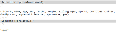

we can convert any list provided by JMP into a robust list of columns via
ColNames = dt << get column names;
colList = Transform Each({col}, ColNames, Name Expr(As Column (col)));

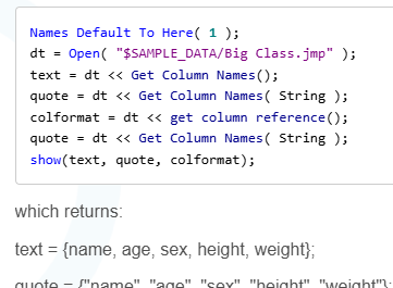

my approach is much more simplistic. I'm careful to build my list of columns for the specific purpose I have in mind. Sometimes I have multiple lists of the columns in different formats.
Names Default To Here( 1 );
text = dt << Get Column Names();
quote = dt << Get Column Names( String );
colformat = dt << get column reference();
show(text, quote, colformat);
which returns:
text = {name, age, sex, height, weight};
quote = {"name", "age", "sex", "height", "weight"};
colformat = {Column("name"), Column("age"), Column("sex"), Column("height"), Column("weight")};
one of the three generally works, even if I have to resort to eval(parse())
