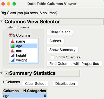

'Cols > Columns Viewer' gives this kind of output with 'Show Summary':

Re: refer to levels of variables
Thank you!!
This is the best most direct way to find the number of levels.
It is a little "hidden" but at least it gives me what I need
