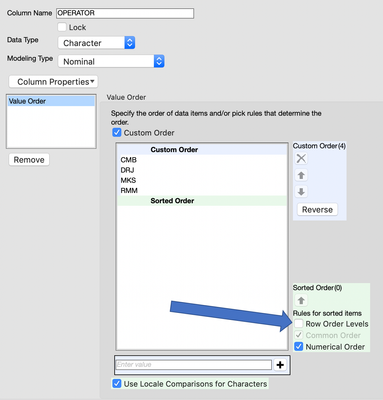

Have you tried turning on the Row Order Property in the column with your labels?
