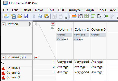

There is no need to duplicate columns as you could replace the values in place.
Starting with table like this:

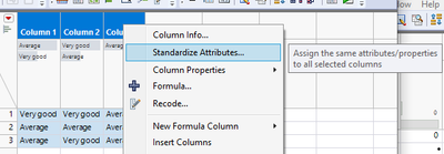

Select all columns you want to modify and right click on column header, select Standardize Column Attributes:

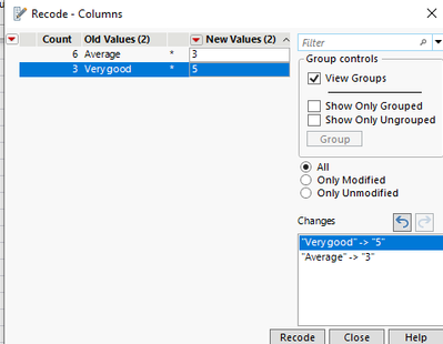

Recode
Click Recode

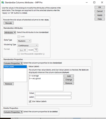

While you still have Standardize Column Attributes open change columns to numeric (and continuous as you want to calculate with them) and set the correct value labels

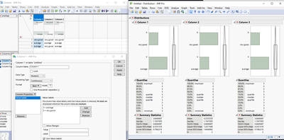

all the columns should now be formatted correctly
