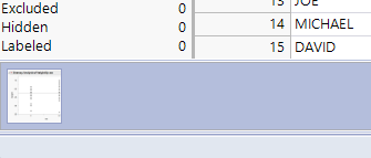

Interactively, the Platforms all have icons at the lower right that when clicked on will bring the data table to the front
and in the Data Table window, the platforms that have been run are displayed across the bottom of the data table window.

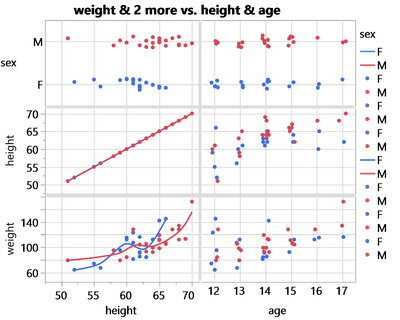

I mean:
which of the entries in the legend on the right  belongs to which of the subplot?
