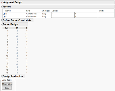

    Once this 4-runs full factorial is done, you can replicate it with the same order using the platform Augment Designs, specifying a "Replicate" augmentation choice with 4 as the number of times to perform each run. You should then obtain the complete "split-plot part" of the design :

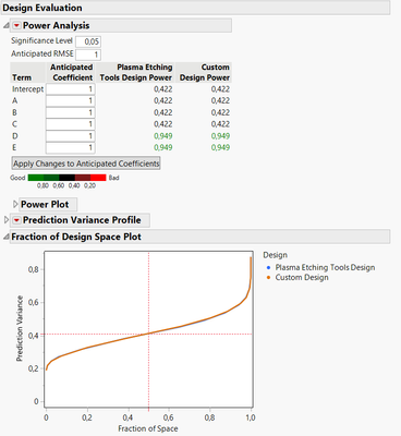

On a side note and "practical" consideration, using the Custom Design platform directly enables to create a design with same performances (in terms of power and prediction variance) :

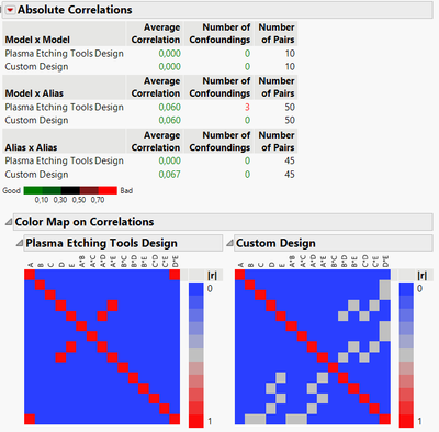

But a different aliasing structure (avoiding complete confounding):
