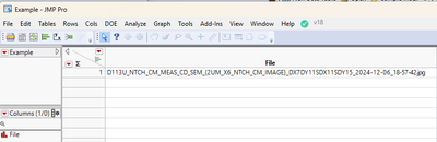

Given the data table

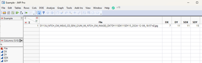

The below script will directly create
Names Default To Here( 1 );
// Create and example data table
dt = New Table( "Example",
	Add Rows( 1 ),
	New Column( "File",
		Character,
		"Nominal",
		Set Values(
			"D113U_NTCH_CM_MEAS_CD_SEM_{2UM_X6_NTCH_CM_IMAGE}_DX7DY11SDX11SDY15_2024-12-06_18-57-42.jpg"
// Add the new columns to the data table
dt << New Column( "DX" );
dt << New Column( "DY" );
dt << New Column( "SDX" );
dt << New Column( "SDY" );
For Each Row(
	// Separate the section of the File name into just the DX,DY,SDX,SDY part
	string = Word( 1, Substr( :file, Contains( :file, "_DX" ) + 1 ), "_" );
	// Change the string into a assignment statements
	Substitute Into( string, "SDX", ";:SD_X=", "SDY", ";:SD_Y=", "DX", ";:D_X=", "DY", ";:D_Y=", "_", "" );
	string = Substr( string, 2 ) || ";";
	// Execute the assignment statements
	Eval( Parse( string ) );
