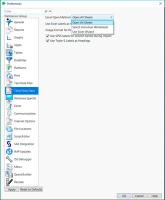

Jeff_Perkinson
Re: problem to open excel
The English translation of the error message:
Excel, Opening files created with a version earlier than Excel 97 may not be successful. In this case, choose the Open all sheets option to successfully open.
It seems that you've tried to open an Excel file in a format that pre-dates Excel 97. If the file didn't open successfully you may find the Open All Sheets preference helpful.
You'll find this preference from File->Preferences... and the Third-party Data section.
@briancorcoran explained why this may be necessary in RE: Error Opening Excel File.
-Jeff

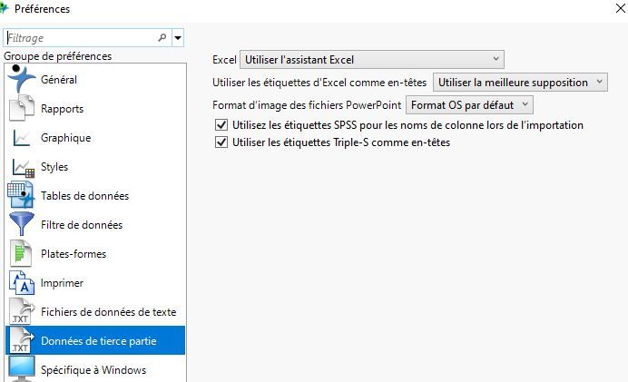

 Hi,
with my Jump (15.2.1), I have no problem to open and you can see my prefernces : excel in the screen image.
the file is an excel office 365 . xlsm.
I shall verify the preferences for the others JMP (there is this problem for 2 colleagues who have JMP 15).
