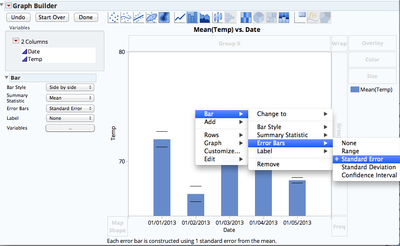

Re: plotting two years data over the same calendar dates with error bars
Have you tried graph builder?

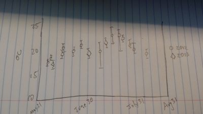

thanks for the reply, but that's not quite what i need.. i need the bottom to show only month and day, with the different years being the two data runs.   i attached a rough hand drawn pic of what i'm looking for.
