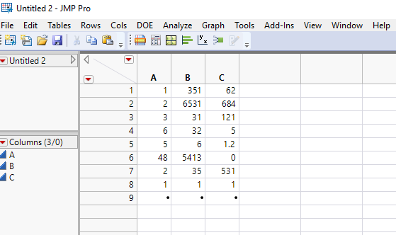

Dear experts, bellow is an example table for what I aim for:
I have the three variables   A, B, and C. A and B are numeric continous and C is numeric ordinal. I would like to fit A and B in Y axes and C in x axes. How can I do it in ftx Y by X? Thanks for any help!

If you use Table>Stack and stack A and B then you will get a table with a column for C, a "Label" column of As and Bs and then a Data column. Now with fit Y by X you can use C as your X and the "Data" column as your Y. The Y now has both the A and B data.

Nice! Thank you so much!
