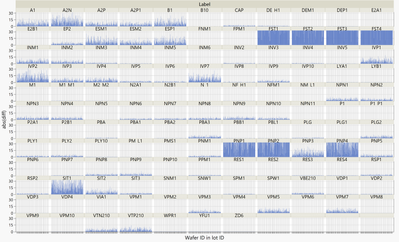

To get all the calculations done by JMP, you can stack the columns and use the column names / labels as wrap.
To calcualte the abs (diff(T0, T48)), you can use the range aggregation of Graph Builder:

Graph Builder(
	Variables( X( :Wafer ID in lot ID ), Y( :Processes ), Wrap( :Label ) ),
	Elements( Bar( X, Y, Summary Statistic( "Range" ) ) ),
	SendToReport(
		Dispatch( {}, "Processes", TextEditBox, {Set Text( "abs(diff)" )} )

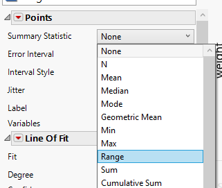

is there a setting to show positive and negative reading rather than "Range"?
i was looking in the control chart builder and the JSL code for control chart.

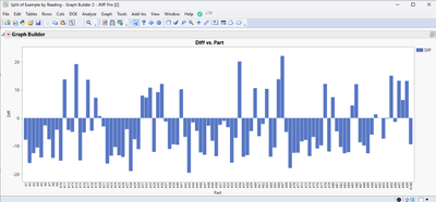

This chart is what i need. it shows positive and negative reading of reading@T48 - reading@T0. How do you get the reading of the y-axis (DIFF)? are you adding one more column for each parameter in the data table to do the math?

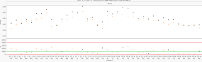

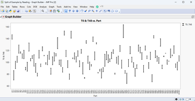

I am aware of the R chart, it has the range, but it is only the positive reading. Here is what I did. Top is X bar chart, but it lists out the reading@T48 & reading@T0.
I am thinking what is the best way to get the diff of 200 parameters putting into something like R-chart but with positive and negative reading on Y-axis. Is there any setting on R-chart might be able to accomplish this or do I need some JSL in R-chart to achieve this?

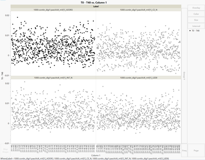

Re: plot something like R chart but showing positive and negative value instead of range.
the code works. i follow the exact steps of code but use the data table, formula and chart builder to generate the plots.  i have to spend some time to debug the JSL code with my data table.
