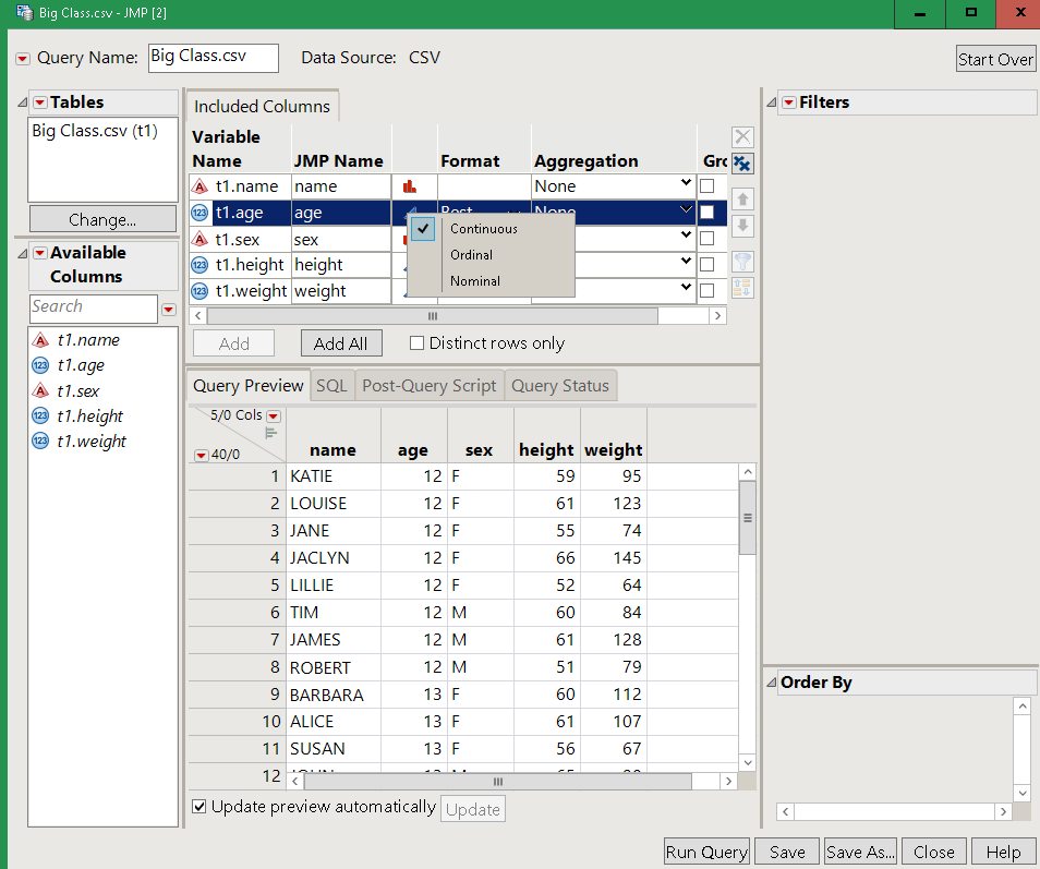

I 'm using the query builder to get data from database. The the included columns from table are a mixed of categorical and numerical type. After I clicked Run Query, a table appears and contains all the columns I needed. However , all the columns appear in categorical type. How I can make sure not losing the data type when query data using jmp?

Here
Right click the icons to get the popup.Right click the icons to get the popup.

Yes, under the included columns window I make sure the data type is continuous. However, the table generated after I clicked Run Query change all those continuous to categorical. Is this a bug?

Add a picture might help too.
Craige

what I saying is:
1) when doing query, the continuous-type columns is there (see left of image last row)
2) after clicked Run Query, the table generate shows the previous continuous-type column become categorical (see right side of image)
3) Thus, I wonder if there is bug for jmp pro 14 query builder ?
4) or, I missed some setting?

14.3 works as I expect, the continuous default is not changed. I'm out of suggestions, except to look at the source script in the opened table; you might be able to change to "Continuous" (or delete) the highlighted bits and get what you need.
