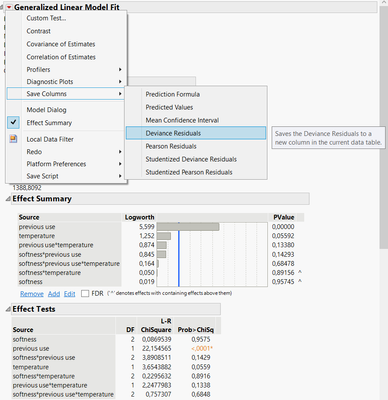

For example on the JMP dataset "Detergent", using "brand" as categorical response Y, I do have the options to calculate directly the deviance residuals and save them in the datatable :
Deviance is an indication about goodness-of-fit for statistical models where model fitting is achieved by maximum likekihood, which may not be used for Machine Learning models that use different loss functions : Deviance (statistics) - Wikipedia
So it may not be possible to calculate it for some models using different fitting functions.
