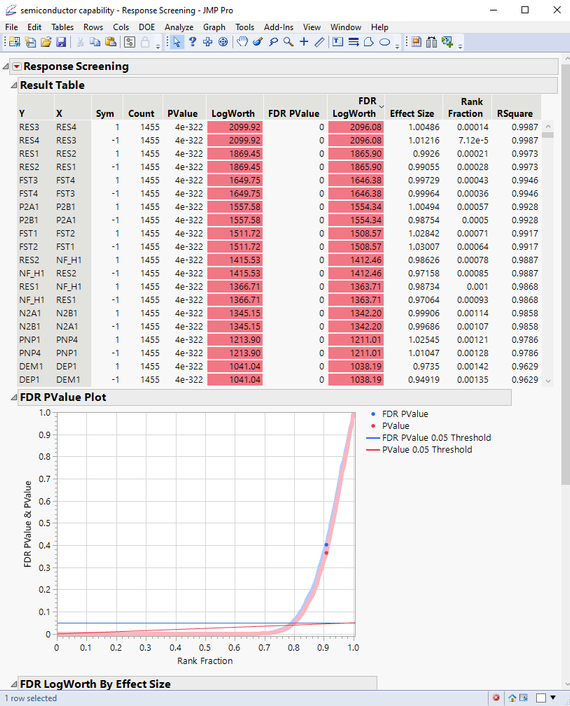

Hi, is there a way to filter (corr>x, or like top 10 corr etc) or to at list to sort  the correlation when i am analyzing  the multivariate correlation results?

You may want to try thr  Response Screening platform.
     Analyze=>Screening=>Response Screening
It is designed to sort and select the results based upon the te significance level.
Jim
ron_horne
Super User (Alumni)
Re: multivariate correlation
Hi @hillel, welcome to the forum.
@txnelson gave you by far the most powerful approach.
Perhaps a more simple approach can be the following:
produce the correlations using the multivariate platform. There, ask for the pairwise correlations. Right click on the pairwise correlation table and select >> Sort table >> By Pvalues >> ascending.

This feature works with any table presented in a JMP platform: First, select Pairwise Correlations from the red triangle menu next to Multivariate. Then right-click in the table and choose Sort By Column. Select Signif Prob and Ascending and click OK. Now the list is sorted from most significant to least significant. If you want to sort by correlation, then right-click and select Make Into Data Table. Right-click on the Correlation data column and select New Column Formula. Choose Transform and Absolute. Now click Tables > Sort to finish.
