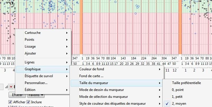

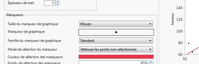

Re: marker size
Hi,
I 've already made it.
I don'understand why in the same graph, the point have not the same size but they have the same size in the details of the graph.
see the differences betwenn the black and blue point.
Other question: How to fix the form of the point?

Re: marker size
at the beginning, the  data filter context box is selected on the year 2020.
When I add the year 2019 to 2020, JMP change the size and the form of the points while in the script, it is written size 2.
