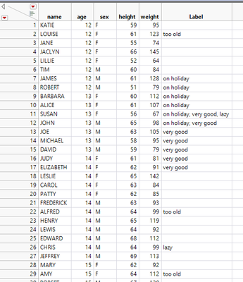

As the wish was rejected today, I took Jarmo's code and generated my  universal "label" function
You can put it into a toolbar or link it to a keyboard shortcut.
Then you can iteratively selected rows, run the script and label the selected columns.
Previous labels will no longer be deleted.
Then the label column can be used for exclusion and highlighting ... and to keep track of the idea behind the decision ...
Less drastic than nuking the rows out

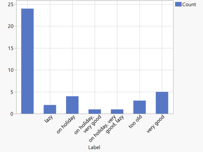

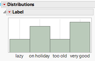

Is there a list of plots and report types that support "splitting" of multiple response column entries like "Distribution" does?
jthi
Re: manual grouping - extended version?
I'm not sure if there is such a list, but JMP17 will add support for Graph Builder (New in JMP17).
-Jarmo

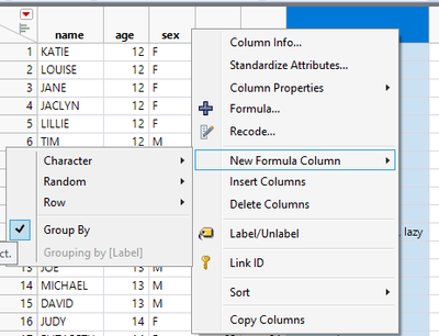

another thing:
I think it's a good idea to auto-activate NewFormulaColumn/"group by" for the label column.
Is there a jsl code to do so?
Unfortunately, the advanced log doesn't record this action and the new formula column menu doesn't shop up in the Menus and Toolbars dialogue.
