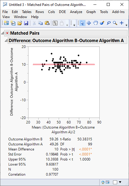

Statistical inference is helpful when observing the entire population is impossible. The population is not defined in your post. Statistical inference assesses the uncertainty in the estimation of a parameter due to sampling from the population. Compare the two algorithms based on a measure of efficiencies such as processing time or processing steps using the same sample of data. This case is a paired comparison that can use the paired t-test on the continuous outcome of each algorithm.

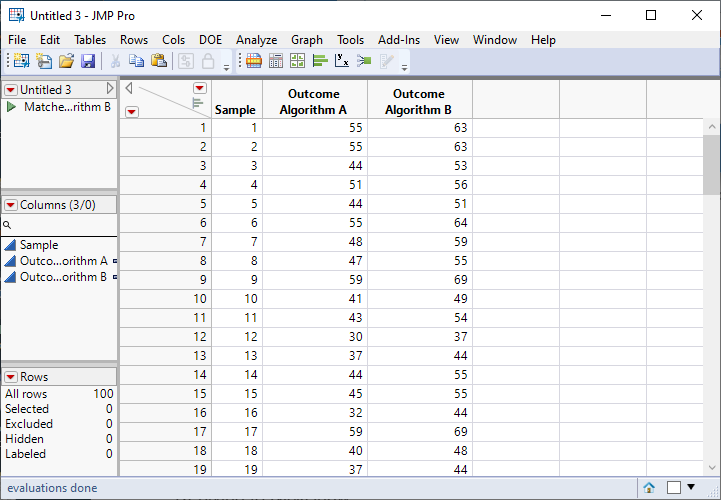

Your data might look like this table:
I mocked up some data. There are 100 samples of data from the same population. The samples could be from resampling or bootstrapping. The outcome is the number of seconds to complete the algorithm.
You can analyze these results using Analyze > Specialized Modeling > Matched Pairs.
This example shows a statistically significant difference between the two algorithms of about 10 seconds.
