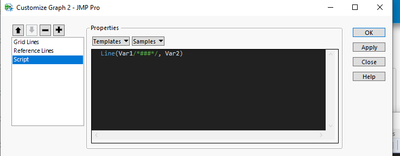

Everything is running fine until I save the journal. But when I re-open this journal from an other jmp session or even if I just run "clear globals"  I loose everything. In fact , in the journal script, my variables keep their name and if I erase what is assign to my variable then the script of the journal will be bugging ( as it does not recognize  anymore my variable).

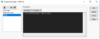

I'm using JMP16.2 so hopefully the issues are same. I get following error message Name Unresolved: Var1 in access or evaluation of 'Var1' , Var1/*###*/ which tells me that when the journal is re-opened the variables are no longer defined. To avoid this I would try one of the methods found fromInsert one expression into another using Eval Insert, Eval Expr, Parse, and Substitute . These will allow you to evaluate the values to the graph box instead of just leaving it as Var1 and Var2. Below is an example using Eval(EvalExpr()).

Non-evaluated:
Evaluated:
