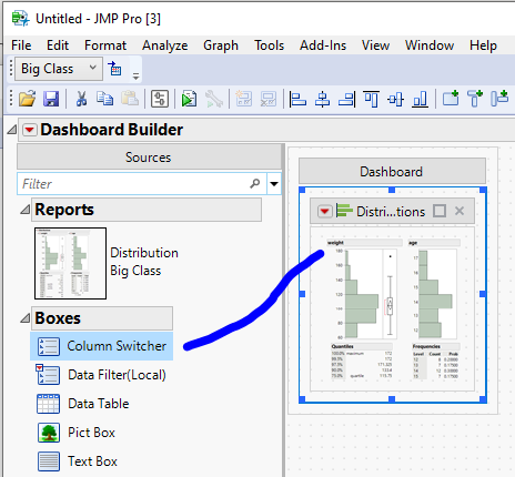

John_Powell_JMP
Re: Column switcher in JMP 16
Here are some other options...
On Windows, if you have the toolbar visible, you can click on the Column Switcher button.
if you are building a Dashboard or JMP Application, you can drag the Column Switcher from under Boxes to the report and have it affect multiple graphs!
Read more about editing Dashboards here: https://www.jmp.com/support/help/en/16.1/?os=win&source=application&utm_source=helpmenu&utm_medium=a...
 Enjoy switching columns.
