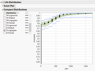

There is a class of ZI distributions supported in the Life Distribution platform. It includes: ZI Lognormal, ZI Loglogistic, ZI Weibull, and ZI Frechet.
I attach the updated data table with a new script. This platform, however, does not take covariates.
Here is a screenshot of fitted ZI Loglogistic.
