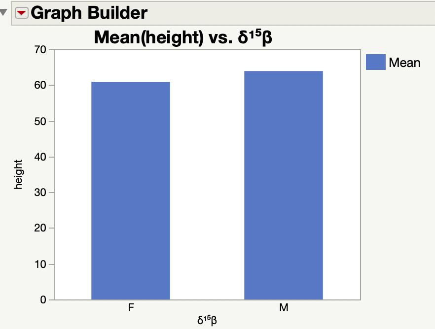

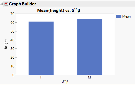

Thank-you. The solution is imperfect. In the column header and the graph y-axis title, both the 1 and 5 are superscripted but the 5 is higher than the 1. Is there an issue with the script you provided or is this the best we can do? The outcome is unacceptable for publication. I hope that jmp will be able to resolve issues with superscripts, subscripts and greek letters as scripting and finding unicode symbols is cumbersome.
I see this result:
and this result:
The results above used JMP for Windows on my work computer. I repeated the test on my personal Macintosh and now I see the same result as you:
So this result is a bug and should be reported to JMP Technical Support ([email protected]).

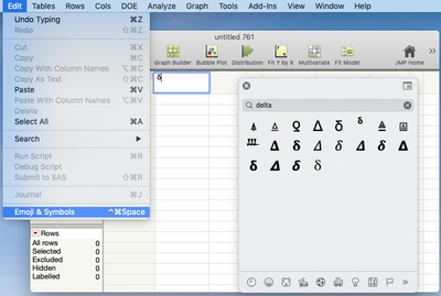

Instead of using the script editor solution that @Mark_Bailey provided, I would use the Emoji and Symbols tools (Ctrl-Command-Space) to enter these special characters.
You can type the name of the character you're looking for into the window and see the choices.
As for the different line heights for the 1 and 5, it's not so much a bug in JMP. Instead it's the way the font chosen for the column headings and the titles renders the UNICODE characters for superscript 1 and superscript 5. That's not something JMP has control over.
Instead, you'll need to find a font that renders them at the same line height. I used Pages on my Mac to experiment with various fonts and found that Myriad Pro, which I suspect I got with one of my Adobe products, does a good job of rendering them at the same line height. You may have to search a bit to find a font that you have installed that works the way you want.

I found a font that worked for the coumn header but when I made a graph using this column, the superscripts were misaligned. I tried changing the text in the axis title, no luck. So Jeff's solution was also imperfect.
