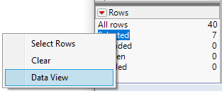

a right click on hogi_1-1667417754319.png doesn't seem to be the right way ...
