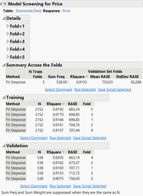

In order to see the individual results for each fold, you can try to use instead the "Model Screening" platform ("Analyze", "Predictive Modeling", "Model Screening").
You'll enter your factors and response(s), check the "K-fold cross-validation", specify the number of folds, and simply check the "Fit Stepwise" in the menu "Methods".
Then, you should have your individual folds results for training and validation like in this screenshot :
Be careful not to do "cherry picking" and choose to use the fold with the best results, as it will mean you are choosing the training and validation set in order to get the best results, which is not the target of this validation technique (and not the objective of a validation at all). It's more for assessing the robustness of a model in the context of small dataset, where no data is "lost" or excluded in the validation set.
