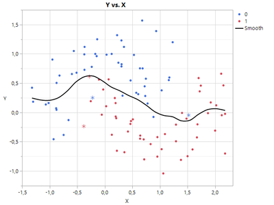

I'm not really familiar with KNN, but the first idea for vizualization I would have, is to give the wrongly predicted a different marker. See screenshot below. It is the u-shaped data, KNN with K=4 gave the best result.
  • saved prediction formula
  • made new formula to compare true class and predicted class
  • use that formula for marker shape
There is also an efficient function for finding next neighbours, we could use that, to find e.g. the range of the wrong points and give it a different look. Perhaps this helps.
